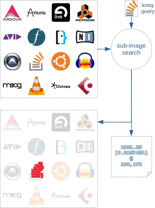

A similar problem exists in the imagery field and fortunately anyone can solve it using the following ImageMagick command:
compare -metric <metric> -subimage-search <full-image> <sub-image> <output>
In the following illustrated example, a part of the Stackoverflow logo, highly JPEG-compressed, is searched inside a bigger image made up of 16 different logos.
[sub-image-search.png]
The metric used here is RMSE which gives good results. Fuzz, MAE and MSE give the same correct result, contrary to AE, MEPP, NCC, PAE and PSNR which should be avoided in our case.
The relevant information here is the precise location of the sub-image inside the full image. It is provided by ImageMagick as (X,Y) coordinates written to the standard output just after the @ symbol:
1031.85 (0.0157451) @ 108,178
Figures on the left can be ignored since they just indicate how "intense" the match is.

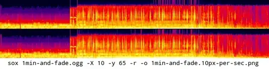

Here is a spectrogram example of the first minute of D.A.N.C.E. by French band Justice:
[spectrogram-render-examples.png]
By doing the same with an audio query, it is now possible to use the sub-image search technique on audio files. Here are a few examples with different <time-precision> parameters (1px/sec and 10px/sec):
[spectrogram-search-examples.png]
