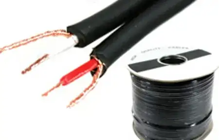

No, you probably looked at a shielded twin pair cable like this one:
And that is actually four leads, not two.
A twin core cable like this one could also be used (it is only three leads as the shield is shared):
