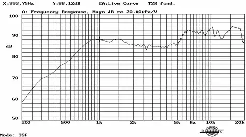

The average frequency range (the linear portion of the typical frequency response curve for phone speakers) is about 500-5000 Hz (source 1, source 2), and one speaker manufacturer produced this frequency response chart (source) which does show a shifted range towards the higher end (it is more like 1-10kHz:
phone speaker frequency response
This means that you should definitely avoid too much action in the low region < 500 Hz as it likely will introduce distortion/decreased dynamic range.
