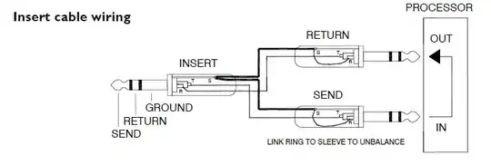

a. whether I can actually test it safely without a proper fx proccesser? b. If Insert cables are the same as a stereo split cable i.e.: and can I use the one I have see link
http://www.pmtonline.co.uk/media/catalog/product/cache/1/image/1000x1000/5e06319eda06f020e43594a9c230972d/5/7/57866-dolphin-premium-1m3ft-split-63-stereo-jack----2x-63-jack-deluxe/pmtonline-stagg-st81444-31.jpg

Q1: I've done some research, and yes, you can use the Stagg Stereo -> 2 x Mono cable in the link. It will work as an unbalanced insert lead.
From A&H Zed 24 Manual: enter image description here
Q2: To test the insert connections, you just need to find out if the signal is being sent/returned through the mono jacks. You could do this by connecting the Mono jacks together; tip to tip. You could use a crocodile clip wire if you wish.
