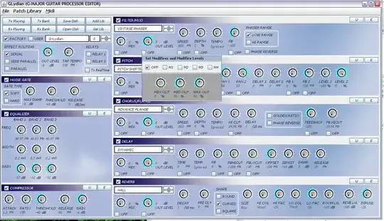

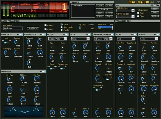

I am aware that this is not a direct answer, however if the main problem is that your knobs are broken and you want a patch editor for the T.C. Electronic G-Major, take a look at these editors.
You may also be able to contact the authors and get some info from them about the sysex format:
GLydian: http://www.rig-talk.com/forum/viewtopic.php?t=11963
GLydian Patch Editor
Real Major: http://realmajor.haax.se/index.htm

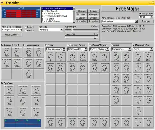

Another that i found is FreeMajor but is more or less as anothers editors. Really i don't found any that control I/o, routing, mod, midi util ... etc. Only control presets and effect parameters FreeMajor
