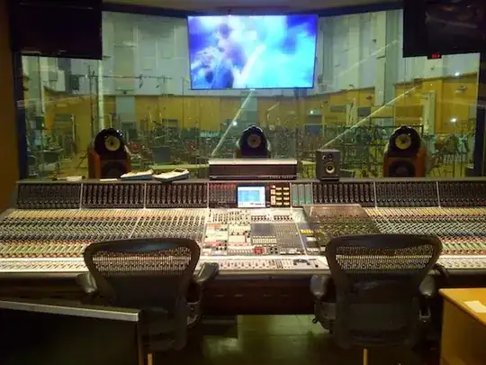

1. Make Song (Record Initial Tracks): This is typically the stage where the audio is actually recorded and the sampled/synthesized tracks are created. This is the stage that occurs in what most people call a "Recording Studio". In keeping with our example this is the stage where your goal as an engineer would be to capture good audio. The balance of tracks is less important here and you will be focusing primarily on capturing each individual track accurately. While some takes are done with full bands you will typically be recording one instrument at a time or possibly bass and drums together. Here you may use some EQ to get the sound you want but generally the tracks will be recorded as clean as possible.
This will occur in a place like this (Abby Road) enter image description here
