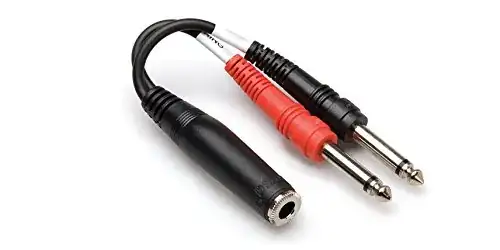

I have dual mono 1/4" jacks for the main output from my soundboard. I currently, only have the left side being sent to the amplifier for the auditorium speakers. I'd like to have both left and right sides mixed into a single mono signal to then send to the speakers. In my past, I'd just use a simple mono-to-stereo splitter adapter backwards. For instance, I'd just use an adapter that looks like this one:
Example Mono-to-stereo Splitter Adapter (Hosa YPP136)
But I worry that hooking it up that way isn't really the "right" way to do it. If there's no problem with doing it that way, I'm all for it, but if there's better, recommended way to combine stereo into a single mono line, I'd love to know what that is.

Well, as you've noticed yourself, it will normally work. This is because both channel outputs should be expected to have the same output impedance, so wiring them parallel effectively creates an averaging circuit. However, this is not really an intended mode of operation.
  • The output impedance of this combined output will be half the individual impedance, which generally won't matter at all.
  • More problematic is that for strong side-components in the signal, the outputs perceive essentially a total short circuit. If the outputs have particularly low impedance (like headphone outputs), this can drain significant amounts of current, but again unlikely to be an issue except for battery-powered operation.
  • Finally, if the impedances do not quite match (output impedance is normally not something that needs to be calibrated precisely) then the stereo balance will be off in favour of the channel with lower impedance. This is still probably harmless, unless you're dealing with complex wide-stereo material.
Nevertheless, the "right" way would probably to mix in mono right in your soundboard, and route out only one single channel. But if that isn't possible for some reason, I'd just stick to the Y-cable hack. Of course, you can always use a small dedicated mixing console for the task, but probably you wouldn't really notice the difference.
