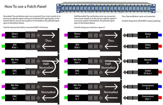

It is called a normalled bay when in the context of a patch bay. See graphic explanation below.
In your case though, it sounds like you want a monitor controller or small mixer.
See: Mackie Big Knob as an option with a lot functionality.
