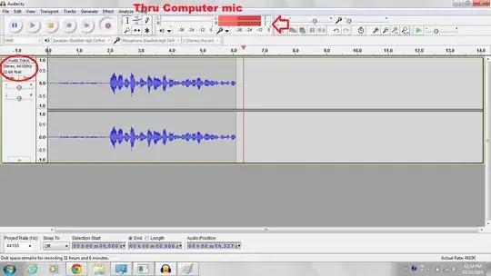

Recording thru computer mic

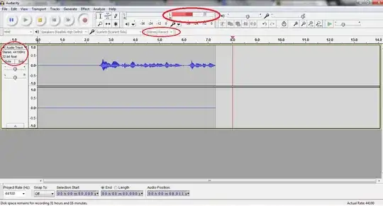

Inspite of setting to Stereo it records like this . Would any of you know what can be the problem? I have checked all connections - all are fine. Is this a problem with the xlr cable?

    @Tetsujin, usually when, I record through the built in mic in my computer, it records & shows on both channels. Y is this happening only when I connect my condenser mic? Ideally it shouldnt happen – Stan Nov 22 '14 at 18:19
  • the built-in mic input is mono, the Focurite isn't. – Tetsujin Nov 22 '14 at 18:25
  • @Tetsujin , I added another image please take a look at my question. the built-in mic being mono, it records both channels , but with the focusrite it only records left channel – Stan Nov 22 '14 at 18:28
    Correct - exactly as expected. – Tetsujin Nov 22 '14 at 18:28
  • @Tetsujin , wait so you said the Focusrite isn't MONO rite, but the comp mic is? so that means that the focusrite should record both channels, right? – Stan Nov 22 '14 at 18:35
    it has 2 channels, you're only using one. I still don't know why you want a mono recording across 2 channels. Makes no sense to me. & the Focusrite is, of course, recording both channels... just you have no sound going into one of them... – Tetsujin Nov 22 '14 at 18:36
