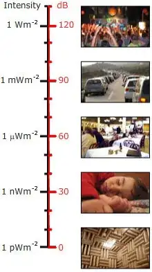

According to the scale on this page, 0 dB (aka 0 dB-SPL) is the sound level in a recording studio:
dB scale
We said above that the decibel is a ratio. So, when it is used to give the sound level for a single sound rather than a ratio, a reference level must be chosen. For sound pressure level, the reference level (for air) is usually chosen as pref = 20 micropascals (20 μPa), or 0.02 mPa. This is very low: it is 2 ten billionths of an atmosphere. Nevertheless, this is about the limit of sensitivity of the human ear, in its sensitive range of frequency.
0 dB = 20 μPa = 20 μN / m² = 20 μJ / m³
