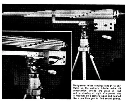

Anyone ever seen one of these or played with one before? Its been floating around for quite some time now. I found it a few years ago and just stumbled upon it a few days ago. I'd imagine if you took one of these in a public area you'd probably get some funny looks and perhaps a bit of trouble...
The physics behind how it works is awesome.
alt text
alt text
The PDF gives cross sections and rough instructions on how to build one. I'd love to hear one sometime, but it looks like quite the project to build one.
Download the pdf here

So, I felt rather adventurous today, and, having successfully made a hydrophone earlier this week, I felt fairly confident in my building skills as well. So, I decided to attempt to make one of these. The article calls for aluminum tubing, but although I felt confident, I didn't feel confident enough to drop $200 on this project. I, like Selcuk, often turn my DIY projects into RIY projects. So I decided to make a prototype out of PVC pipe (which dropped the construction price to $25 - a admission fee worth the fun even if I fail...). So, if it works, and fairly well, I may venture into making one out of aluminum. We'll see...
I bought the pipes today, as well as epoxy and such. I've gotten the main pipe system almost put together, but I ran out of epoxy around midnight, so I'll give it a rest til I can get some more tomorrow.

Once I'm done with the project, I'll post a blog about the whole process, as well as recordings (however they turn out...)
Wish me luck!

  • So, I've found out that 1/2" pvc pipe is actually 3/4" because of how thick the walls have to be. I'm already cheating a little because the article asks for 3/8". So, my model will be the same length, but twice as thick as the one they made. Theoretically, this should only change the amplitude (and hence the dynamic range) of my mic, which could end up being a good thing. Hopefully it won't adversely affect the directionality. It'll be interesting finding a pickup big enough to work with it. We'll see... – Colin Hart Mar 12 '10 at 14:40

    Finally got up the blog post with more pics and a few recordings: http://bit.ly/c6mVkm
    I'll hopefully have a few more recordings up soon.

  • I did. I have a few recordings on my blog. Didn't come out exactly how I expected it to (I explain why there...) so I'm planning to eventually make some modifications to try to improve on it.
    Let me know what you think!
    http://www.colinhartonline.com/?p=141

Very interesting project. I have seen these plans posted in other places. The weakness of this design is that you will actually need a separate microphone at the end of each tube, instead of a single mic at the end of the funnel. The tubes may resonate and amplify, but whatever gain they have is lost in the "collector"--i.e. the area inside the funnel where the tubes join.
The length of the tubes are set this way to allow each microphone to pickup a different frequency. So let's say you had this attached to a graphics equalizer. You can then separate frequencies.
This design can also be used if you use a funnel at the end. EDIT:The article I had used a single mic in a funnel. I suggest an astatic D-104 cartridge.

The original Article is in here, somewhere in the back of that Issue of Popular Electronics 1964
https://www.americanradiohistory.com/Archive-Poptronics/60s/64/Pop-1964-06.pdf
I built one of these mice back in 1964. Luckily I was ably to walk into a very large hardware and buy the called for aluminum tubing. There are 36 tubes w Of which the longest is 36 inches, each being 1 inch shorter than the rest. My only problem was in keeping them all together. Epoxy worked. The mic works well as it does a fine job of cancelling unwanted noise from the side. A strong wind is problematic. I used the mic and amp from a tube type hearing aid. Ron Rudiak, Steinbach, Manitoba, Canada
I build and tested the design in PVC tube years ago, when the original article came out. It works OK, but the sound is strange, like you are in a tunnel. Building it in aluminium would be worth a try.
-1
If you can get hold of it (public library?), an original construction article:- Popular Electronics June 1964 (!). Used 37 , 3/8" ext diam Ali tubes Only one microphone is used.
