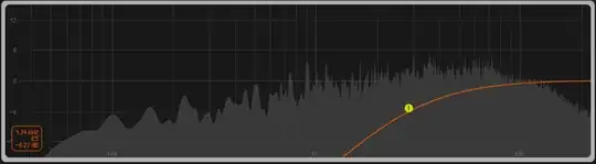

Ok, so, I load a song into a Live clip, and I add an EQ device, and I cut off low frequencies below about 1.28kHz. However, this is what the frequency visualization shows me:
the red line of the filter completely drops off at 1.28kHz, but the frequency of the song is still very high below that point
Far from ending the frequencies at 1.28 and rounding them in above that, it seems that many frequencies, the whole way down to 50Hz, are still in this audio. And indeed, the human vocal range ends at about 1100Hz (though Jeff Mangum's seems to be centered around 610 in this song), but the singing can still be heard very clearly with this EQ in effect (& it doesn't just sound like overtones).
So I could "eye it up" to ensure that I don't, in this particular song, see any frequencies leaking in below my cutoff. But that feels incredibly unscientific. Is there a better way to EQ or limit my audio to get the (admittedly strange) effect I want?

Using a higher order filter will give you a greater roll-off slope in the filters stop-band. So a 1st order filter has a roll-off slope of -6db/octave, 2nd order filter has a roll-off slope of -12db/octave, 3rd order filter has a roll-off slope of -18db/octave, 4th order filter has a roll-off slope of -24db/octave, etc. This means the filter does not act like a brick wall and some frequency content beyond the cut-off will be present, but at a corresponding reduced level. Also remember that the cut-off frequency is the point the filter has reduced the level by -3dB (also know as the half-power point or the signal level has been reduced by 0.707).
Most audio filters have a fairly low order as we normal want to hear frequencies being reduced in a fairly slow way. Most common are 2nd order, -12db/octave or 4th order, -24db/octave, but sometimes 3rd order also pops up. Typically, it is rare to see much higher order filters implemented. However, you can achieve an accumulative result by using filters is series, that is feeding your audio into one filter and then the resulting audio into a second filter. So if you used 2nd order filters the accumulative result would be -48db/octave reduction.

Those combined EQ + spectroscopes can seem a bit misleading. The curve on your EQ isn't always what's actually happening, and similarly metering is only an averaging of the signal because audio is a much faster rate than your monitor. With a regular eq it's really more about using your ears to find something that works. You might be better off using an FFT filter for this, you will have more accurate control of individual frequencies which may be better for you.

This is not possible by traditional, analogue means. As said by Bit Depth, such filters have a property called the order. What that means: the response of a filter of order n can be written as
              ( an ⋅ ωn + an-1 ⋅ ωn-1 + ... + a2 ⋅ ω2 + a1 ⋅ ω + a0 )
A(ω) =  ———————————————————————
              ( bn ⋅ ωn + bn-1 ⋅ ωn-1 + ... + b2 ⋅ ω2 + b1 ⋅ ω + b0 )
For this to be exactly zero, the numerator must be zero. That's a polynomial. As we know, a polynomial can only be zero at single, discrete points1: so you can perfectly filter away a single frequency with a notch filter, but you can't completely "kill" an entire band, only attenuate it. In particular, to get a roll-off, the best you can do is use the denominator. If that grows towards infinity, then the response goes to zero; but it can't grow faster than ωn, so even at high frequencies there's always some signal left.
Well, except of course, if you use an infinite order filter! This doesn't exists in the analogue realm, and since most EQs are at least modelled after analogue circuits you usually won't find it there either; but it can actually be approximated pretty well by digital means: by convolution. Because the convolution kernel is a sinus cardinalis function, such a filter is called sinc filter.
Convolution is mathematically infeasible if you do it directly, so these filters are usually implemented with some fourier-transform trick. Hence, the plugins are often called something like "FFT EQ", but strictly speaking the correct name is FIR filter. That's indeed the name of that plugin in Reaper, you can try it out: ReaFIR.
