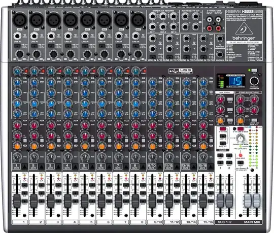

Perusing the Behringer website they have all different notations for Bus. What does it mean to be a 4-Bus mixer compaired to a 4/2-Bus mixer? Or, even a 2/2-Bus mixer?
I don't believe the current answer is clear or useful. Please review the products above which have pictures of the Mixer. For instance, the 2/2 mixer bus has 3 labeled "aux" and one labeled "FX Send" how does that make 2/2 with the below answer?
Behringer X2222USB
Evan Carroll
  • 1,123
  • There are three aux busses. Two are red in the picture. They are both capable of sending pre fader. The yellow FX bus is post fader only. That is your 2/2. Apparently, Behringer decided that the sub-mix busses and the pre-fader aux busses were the important ones to include in the product name. You are looking for standards where there are none... like I said. – JoshP Nov 09 '12 at 02:10
  • I can appreciate the frustration with the lack of a standard. But knowing that just means that you can't rely on the name of a mixer to divine the specs. You'll just have to read the "features" and "details" in order to get the complete picture. – JoshP Nov 09 '12 at 02:14
  • I get that there is no standard, but certainly there must be some meaning within the same company here is another mixer, the yet to be released Behringer UFX1204 (picture of the front of the mixer). It has two-auxs which can alternate between pre/post fader. Wouldn't that make it a 2/2 mixer and not a 4-Bus mixer? Are these definitions that shitty even within the same brand? I can't help but feel that they mean something. – Evan Carroll Nov 09 '12 at 08:30
  • In that one, designated a 1204, they're referencing the number of inputs and mix busses, 12 and 4 respectively. The aux busses are not referenced in the name of the device. Also, in following with my edit below, if Behringer was consistent with their own naming conventions, the mixer would actually be a 16/4. That is, 16 simultaneous tracks over USB going to the computer, and 4 coming back... simultaneously. – JoshP Nov 09 '12 at 19:46
