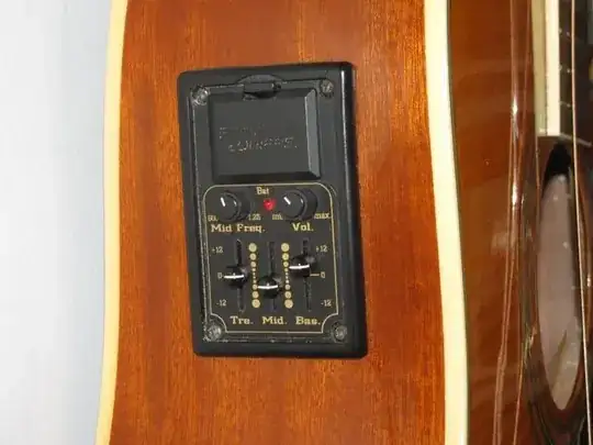

I have an acoustic guitar - a Cort MR750 dreadnought, from about 1998 - with a Fishman pickup system that came pre-installed in the guitar. I haven't been able to identify the type of pickup or preamp, although I have emailed both Fishman and Cort in an attempt to get more information.
There's a continuous hum coming from the guitar, that mostly goes away when I grab the metal end of the cable jack, making me think that this is a grounding issue. Changing cables, mixers, amps - none of this makes a difference, the hum is still present.
It's also worth mentioning that the problem came upon me quite suddenly, in-between two gigs about two weeks apart. The guitar was subjected to no unusual stresses in that time, aside from being carried in the trunk of a car in the cold (but it was very well protected, in a hard case with nothing on top of the guitar).
The preamp has no identifying marks, other than saying "Fishman Equipped". (Or, if there were such marks, they've long since been worn off.) But here are pictures of the preamp and of the pickup:
So I've narrowed the problem down to the guitar electronics. None of the wires inside are loose (I tightened up a cable that screws into the preamp, and that didn't make any difference), and all the soldered connections inside seem solid. I've swapped the battery and made certain it's connecting solidly, neither made a difference.
How I can go about diagnosing the problem? I'd like to replace as little of this system as I can. (I don't want to order a pickup, only to find the problem is the preamp or the wiring.)
Even better, could this simply be a shielding issue? Can the problem be corrected by shielding the electronics? How does one even do that with an acoustic guitar, by sheilding the interior cables?

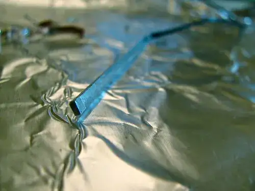

The problem turned out to be either the pickup or the wire to the preamp. I didn't have time to shield the wire - I can't get my hand all the way into the cavity of the guitar, and I don't have tools to work inside a guitar (outside of some skinny pliers and a small inspection mirror), so I elected to simply replace the pickup. It worked; the hum is gone.
It's entirely possible that there was some sort of shielding problem on the previous wire, as this answer suggests, but I can't say for certain. In the past, I've fixed similar problems in electric guitars by shielding the inner cavity with copper tape. (There was no shielding on the endpin jack at all, something that some web sources suggest can cause hum.)
My old pickup:
Piezo
According to Fishman when I emailed them about this:
It sounds like the under saddle pickup element may be faulty. Usually if you touch the endpin jack and the hum goes away, it is a shielding problem within the pickup element.
The email went on to suggest a seller for the part I needed. At first, I was dubious. I couldn't see any breaks in the foil on my pickup, although a small enough tear could be difficult to notice. I realized that the last time I had changed strings, the bridge had popped out, and I might have damaged things by putting the bridge back in carelessly.
So I decided to take a chance and order the pickup. All I needed was to measure the width of my pickup so the replacement would fit in my saddle slot (1/8" in my case), and I was in business; I ordered this part and it arrived in a few days, despite my choosing the option for cheapskate shipping.
After a few dicey moments soldering the pickup's wire onto the mini-jack that plugs into the guitar's internal preamp - you have to do this with the pickup already installed, since you can't get the jack through the pickup hole in the bridge - the installation went smoothly. (I've done this before, although not on this guitar.) The pickup gives me an even volume on all strings, despite being about 1/32" shorter than my existing pickup.
