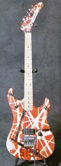

Imagine a guitar with one pickup and no volume or tone knobs. You're right, this would produce slightly less noise (probably less than the noise floor you'd get on any recording - but in theory any component passive component will add some noise). However, you would probably want control your volume/gain sooner or later - thus you would get a volume pedal.
If you wanted to add a pickup (to get a more mellow, smooth sound for soloing or something like that - or maybe you want to lay some jazzy chords during a verse) you would have to add another output to your guitar. Then, either patch both cables to a AB-Y merger/select, then again to the volume.
What I'm getting at is this: Because most guitarist have found that they want to control their tone/balance and their volume/gain, most guitars come with that as default. The same applies to pickups, because most guitars want to be able to get the sound from both the bridge and the neck position (and switch between them, but only connect to one out) a pickup switch is standard.
There are plenty of exceptions.
Have a look at Eddie Van Halen's signature (one picup, volume only):

That said, there are always those that bucked the trend. Nikki Sixx modified his bass to remove the electronics completely, save for a single mute switch. Eddie Van Halen built his iconic Frankenstrat from scratch, wiring it without tone controls in part due to his limited knowledge of guitar wiring. While active circuitry in guitars has seen relatively limited adoption, the same cannot be said of basses, where active preamps are common though still not ubiquitous (still plenty of demand among players for the traditional passive designs).
