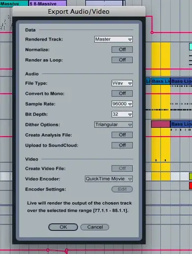

My problem is that when I export the song, the main synth sounds totally different from the way it sounds when I'm working on it in Ableton. The highest possible sample-rate setting I can use is 96000 when in Ableton, so when I export it at that rate it sounds exactly the same. I would just keep it that way if every other synth in the song didn't sound better.

  • @Magrangs, absolutely no changes were made in the project other than changing the export sample rate from 96k to 192k –  Nov 05 '12 at 17:06
  • @Magrangs and all the export options are shown in the screenshots. the ones in white are the available ones with 32 as the bit depth –  Nov 05 '12 at 17:21
