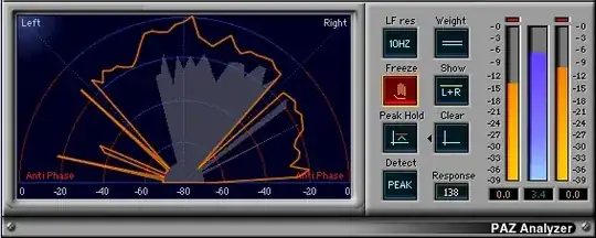

Let's say I have a sound I like. I start mixing down, and I see that it is all over the place on the phase-scope; that is, the signal looks like it has some significant out-of-phase components. I've been told this is a Bad Thing, especially if you want to get your track pressed on vinyl.
Phase scope is all over the place, but it sounds pretty nice.

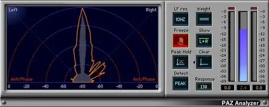

OK, so I squeeze the channel's stereo signal until it's all in-phase. Now it sounds flat and dead. But at least now the phase analyzer looks sane, according to what I've been taught.
There we go, all fixed, but now it sounds dead.
My ears prefer the rich, wide sound I get when the phase scope shows 'too much' anti-phase (maybe I need a second opinion). How much anti-phase content is really bad for a track, and how do I figure out where the threshold is, especially if the wider version sounds better to me?

To be honest I don't use PAZ much I tend to use the DK audio hardware designed for G+ consoles BUT that second one of yours seems WAY to narrow and your first one tilted to the right, with a lot of -phased material.
This is what I mean about "don't use PAZ" (as in, I'm not used to interpret the data as shown) and use your ears/do some testing: "It is a bit tricky to define when a signal is shown by the Stereo Position Display or heard by the ears as “out-of-phase”. This is not simply when the left and right channels happen to have opposite polarity at any given instant. Such a situation can happen if independent instruments are panned to different stereo positions, and it just happens, statistically, that the signal of each channel has opposite polarities. The meter will show a quick spike in the antiphase area. This can also happen if a stereo delay or reverb is applied to an instrument and the delays arrive to each channel at different time" (from WAVES PAZ manual) very true but such a weird language used
  • Good points. My narrowing of the sound would then probably represent the worst-case downmix. So it might lose a little depth in the club, but the element won't disappear altogether. I'll hopefully get to field-test soon. –  Feb 02 '11 at 22:24
