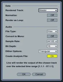

When exporting a song I was working on in Ableton I decided to export it as an .aiff file for the first time, just for kicks I guess, when I noticed some options that I had never really paid attention to. Specifically the option to Normalize the track.
haha heyeah ableton
After a tad bit of research I came to the conclusion that it has something to do with fixing the volume peaks of the song to make it more "normal." I thought that was what a limiter or a compressor does and didn't get how it was different.
Then I read that it is destructive to the sound waves or something? I don't see why someone would want to destroy their sound (unless of course your into death metal or that sort of thing ;]).
So what exactly does it mean to normalize a song and how is this process done?

There are a few misconceptions here. Normalization, in the most basic sense, raises the gain of the ENTIRE track to a nominal level. What you are trying to do with normalization is maximize signal. The relative dynamics of the track are not changed. There are actually two types of normalization, but the most common is peak normalization, where the loudest peaks of the signal are brought up to the highest level they can without clipping or overdriving the signal.
This is very different than compression, which applies DIFFERENT amounts of gain to different parts of the track. This reduces the "loudness" range of the track, make it punchier but less dynamic.
Limiting simply prevents the signal from going over a set limit. It's similar to compression, but it doesn't mess with overall dynamics...just peaks.
And the term "destructive" means that you cannot undo the process, and only applies to this instance within this software. It is not a quality-value term.
