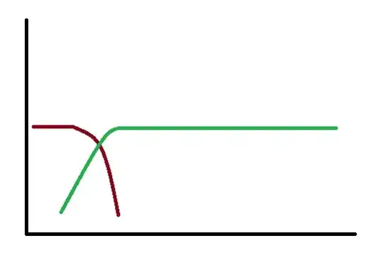

To do this properly, you will need the frequency response curves for both your studio monitors and your subwoofer so that you can get the crossover frequency right:
alt text
In the above graph, the red curved line is the subwoofer frequency response. The green line is the frequency response of your studio monitors. The crossover frequency is the point where the two lines cross.
In an ideal world, the point where they cross is -3db down for both.
