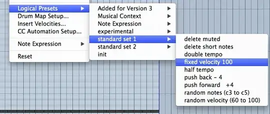

In Cubase 7.5 there is a preset from MIDI » Logical Presets » standard set 1 called fixed velocity 100.
Select your notes and then apply this.
