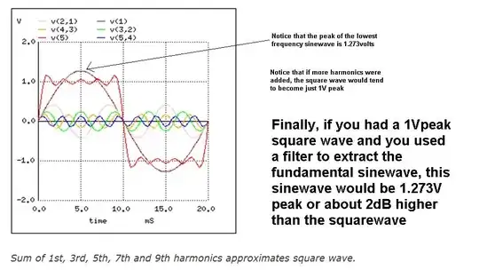

Filtering a signal to remove certain parts of the spectrum on the face of it (and intuitively) should reduce the perceived sound level. This is what common-sense would tell us. However, when it comes to the reshaping of sound with filtering, lowering the sound level doesn't always equate to lowering the peak level. Yes, the perceived sound level may reduce but on many occasions the instantaneous peaks will increase. This does not mean your ears or meters are lying to you.
Take a very simple repetitive waveform like a square wave. If you filtered it to enhance just the fundamental frequency you'd end up with a sinewave (pure tone) that is 27.3% higher in amplitude. This is a peak level increase of about 2.1dB.
When you hear the squarewave you hear the fundamental frequency and all it's harmonics because that is, mathematically how a square wave is constructed. Here is a techy (but good) article that explains how a squarewave consists of a fundamental and harmonics.
If you scroll to the lower half of the page you can see how they've constructed a squarewave from sinewave harmonics. Also notice in the formula (near page top), the 4/Pi - this, if you worked it out on your calculator = 1.273 and is the 27.3% higher in amplitude bit I referred to earlier.
So, in the case of a composite signal of a snare drum, many individual parts of the spectrum may be playing together and various filters may cause the peaks to increase and coincide. Remember the peak value on the meter only has to occur once in a few seconds to give the indication that the resulting filtered signal is bigger.

  • Your distillation is a little confusing to me: it is obvious that at certain points in the time series, the amplitude is indeed larger than the original waveform, but if you look at the graphs, the peak amplitude of the "composite wave" is never larger than the peak of the original waveform. Is this because of the time alignment of the waveforms in their illustrations? –  May 24 '13 at 14:40
  • @Horatio - are you referring to the link? If so look at the graph that shows the sum of the 1st, 3rd, 5th, 7th and 9th harmonics - remember that the square wave will be 1V peak with more harmonics introduced - now look at the size of the lowest frequency sinewave - it's peak value is over 1Vpeak (1.273Vpeak). Now if you imagine have a decent squarewave and removing all the harmonics just to leave the fundamental sinwave, you are converting a 1V peak squarewave into a 1.273V peak sinewave and this has a higher amplitude by about 2dB. Does this make more sense? –  May 24 '13 at 16:12
  • Any ideas how I can paste an image into my answer? –  May 24 '13 at 16:24
  • In that graph the peak value of the original is higher (or equal to the square waveform). Yes you are dealing with a multiplier of 1.2-ish but the harmonics are additive with negative values. I do understand what you are saying, I was only asking (without running a simulation myself) if the fact that the square wave peak never actually is higher than the original sine is due to the all the harmonics used being aligned in time (i.e. is the graph a special case) –  May 24 '13 at 16:27
  • Save the image to disk (or note the url), then edit the post, click the icon that looks sort of like a landscape painting. –  May 24 '13 at 16:31
  • No the graph isn't a special case, you can find this sort of thing in a lot of harmonically rich signals. I haven't done a lot of research into it but i'd imagine composite sounds like drums could be worse. Of course, if the filter you use isn't dead flat in its pass-band this could quite easily throw in a couple of dBs too! I guess, if you can make decent white or pink noise (I use wavelab and you can) you could calibrate your filter to check it. Do you know how to post images - this site doesn't seem to have a picture button when editing my answer? –  May 24 '13 at 16:37
  • Actually, I think I worked it out: in the graphs, the original is a 1.273v and the resulting square wave is 1V, then the following graph show an analysis of a 1v square wave with frequencies which correlate to the frequencies used in the harmonics demonstration. –  May 24 '13 at 16:39
  • OK cool - I think windows explorer was having a problem. It always works for me on EE stack exchange - I was beginning to think I was going crazy!!! –  May 24 '13 at 16:39
  • Are you actually saying that an equalizer cuts or boosts by adding additional waves of different frequencies to the existing sound? –  May 26 '13 at 06:08
  • @MattiasNordqvist - No I'm not saying that. I'm saying that if a harmonically rich sound is filtered, the resulting peak amplitude (after removal of some or all harmonics) can be larger than the peak amplitude of the original sound. The squarewave above is a simple example - it has a peak amplitude of 1V and after all the harmonics are filtered out, the remainder (a sinewave) has a peak amplitude of 1.273V –  May 26 '13 at 10:56
