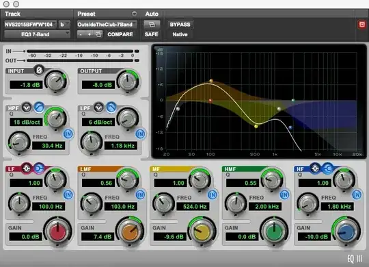

I'm a little late to the party, but I've used ProTools' 7-band EQ plugin for replicating sounds coming from inside of a building, and it sounds great. There are some other things I would do to adjust for specific needs, but this is a good start.
Here is a screenshot of the EQ settings: EQ-Outside the Club
If you were still looking for it, I hope this helped.
