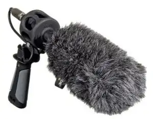

The "dead cat" or "blimp" or "windmuff" type of microphone windscreens are meant to block out outdoor wind noise. They create a dead air space around the suspended microphone, taking a lot more wind noise out than a foamy could.
dead cat microphone windscreen
    +1 on the dead cat. They can make a tremendous difference when recording outside. –  Sep 01 '11 at 23:09
