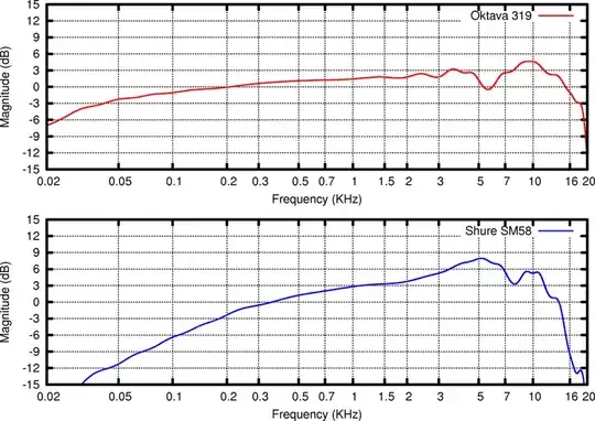

Specs to look for in mics
  1. Impedance: Lower is better - low impedance mics pick up less low-level noise, and transmit high-frequency signals better over long cables. Pro mics can have an impedance of 200 Ohms or lower (Wikipedia)
  2. Sensitivity: The ability to pick up low-volume sounds. Often given as something like "-65dB ± 5dB", which means that some frequencies will pick up sounds as quiet as -70dB, while some will be less sensitive. Higher value with less variance is better (remembering that you're dealing with negatives).
  3. Frequency Response: If a range is given, (eg. 40Hz-16kHz), then this is the range of frequencies that the mic will pick up. A bigger range is better.
    • Frequency response and sensitivity can also be displayed as a graph. In this case, the frequency response range refers to the range of frequencies where sensitivity is high. The graph gives far more information than the range. An example from wikipedia: frequency response graph The Oktava gives a more even response than the Shure. Look for a flat graph, as this gives even volume regardless of frequency.
  4. Polar Pattern: Sensitivity in a given direction. Omni directional microphones pick up sound equally from in front and from the sides. Directional mikes pick up more sound from in front. Shotgun mics are highly directional mics, and pick up sound a lot from in front, and only a little from the sides. Use omnidirectional mics for recording ambient sounds, and directional mics for targeted recording.
Of course, there are many other factors, check wikipedia, and it's difficult to judge a mic purely by the specs.
