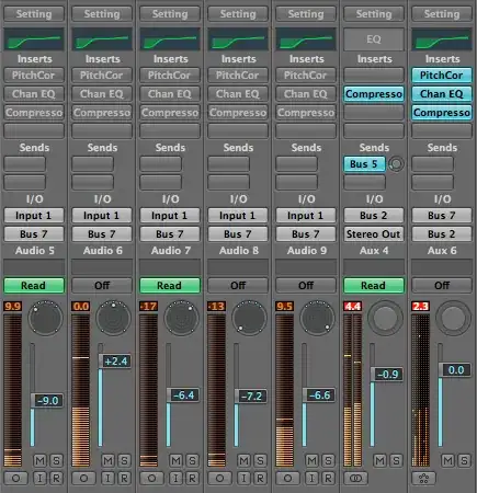

My vocal recording workflow often involves having five or more channels with harmonies of the same part. They have to be pitch corrected and compressed independently and, since I greatly prefer to compress post-EQ, they must all be EQ'd independently too. This leads to a situation where I have five (or often more) identical channel strips with redundant effect definitions (but not redundant DSP) on each one.
This means that to audition an effect change, I must change one and then duplicate it across all other vocal channels, which often leads to a reluctant approach to refining the effects on what tend to be the most important parts of a track.
What I would like is a way to effectively alias effects such that I can change one defining effect parameter and have it propagate to all the other channels automatically. Is this possible? If so, how?

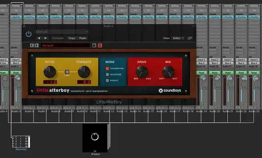

I often encounter this situation. In fact this is how I bumped onto your question since I again have that situation (some 10+ back vocals that all need to be pitch shifted -100 cents).
If you have the option of using a project template the best thing I found out to work is to create environment patching with a single control for a parameter across multiple tracks.
It is not that hard to do it and Logic is great for this. But it takes some time so it only makes sense if you have either really 10+ channels or can have a template with prebuilt environment for multiple similar channels.
Workflow is like this:
1) Open MIDI Environment
2) New Monitor
3) Tie any of the channels to the Monitor (little triangle on the top right of channel drag to similar on Monitor)
4) Move the control you would like to use on multiple channels (for me it is pitch)
5) Check the value on the Monitor. It will be something like F2 1 63
In fact it is a MIDI msg. First parameter is used to map a plug in on the channel. 2nd is the parameter of the plugin you are changing. 3rd is the value.
6) New Fader (type you like, I use Knob for this because thats how it is in the plugin, a rotary knob)
7) In the left side inspector, set
Output: Fader
Channel: First parameter (what is right after letter F in monitor)
Parameter below Channel: the 2nd number
Leave rest as is.
Logic Environment Fader settings for Monitor Data F2 1 63
8) Now connect Fader (small triangle) to a channel and you will be able to control the parameter with the Fader.
9) Connect Fader to all chanels and.... Voila! That's it.
Good thing is that it works real time so you can make a lot of crazy stuff with that also :)
Logic Environment for multiple channel plugin parameter control
