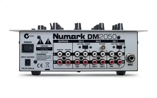

When trying to record a mix from my vinyl turntables, to my laptop, I'm getting heavy distortion, especially during the heavy bass sections of the mix.
I'm running my turntables into a 3 channel mixer, then outputting via RCA "Record" ports, to a small headphone jack into my laptop's microphone port.
My mixer is a Numark DM2050 3 Channel Mixer
I've tried using Windows Sound Recorder and Audacity, but these both produce heavy distortion.
How can I avoid the heavy distortion caused? Someone has told me I'm supposed to use "line-in" on my laptop, but I only have headphone and microphone ports. What is the difference with "line-in" and is this what I should be using?

  • @horatio Assuming that your 3 channel mixer has phone level inputs and line level outputs. I'm not certain whether my mixer has these levels. I've attached a link to the mixer in my question. Can you see whether it does? Cheers! –  Mar 09 '12 at 09:14
  • @Curt On the mixer, make sure you're using the inputs that have an associated "Phono" mode switch, and set that switch. –  Mar 09 '12 at 12:09
  • @KevinReid Cheers, can you see where this switch is on my mixer? (image and link provided in question) –  Mar 09 '12 at 12:14
  • @Curt They're right in the picture, and that's all I was basing my remark on — see the slide switches above the right-side jacks of Ch 1 and Ch 3. Whichever one you use, slide the switch to the Phono position and use the jacks below it (marked with a line to the switch). –  Mar 09 '12 at 12:17
  • @KevinReid Ah you're referring to the inputs on the mixer? These are both set to "Phono" and I have Studio Monitors connected to the "Master" output, and this works fine. So I don't think this is the issue –  Mar 09 '12 at 12:18
  • @Curt OK, that sounds fine; I misunderstood what your question in response to horatio was. (Any input or output not marked as something else is probably line level.) Given the current info, I agree with filzilla's answer that the problem is probably using a mic-level input on your computer (these usually have a symbol of a microphone) rather than a line-level input (usually marked with an arrow pointing into a circle), and that the Right Answer is to get a line-level input peripheral. –  Mar 09 '12 at 12:23
