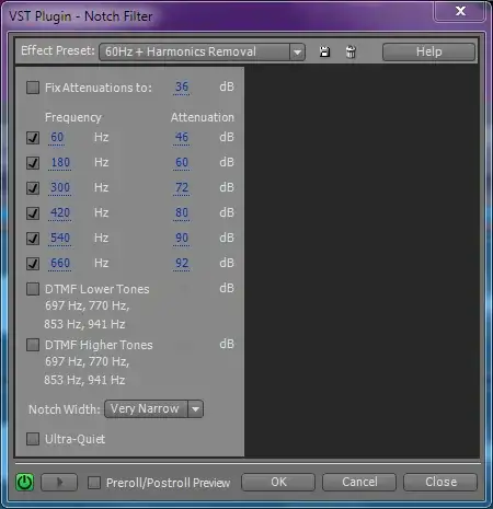

Try a narrower notch filter instead of an EQ. And remember it's not just 60 Hz, but all the harmonics, too (120 Hz, 180 Hz, etc.) To avoid ruining your guitar sound, maybe only enable the filter during the quiet parts?
alt text
