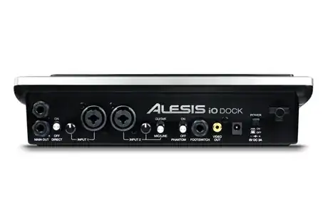

Not many. The current king-of-the-hill here is the Alesis IO Dock. It gives you two XLR-1/4" combo jack inputs that have adjustable impedence on them that'll let you go from consumer grade to professional grade line level and mic level input impedences. It also can do Hi-Z on input 2 for direct connection of a guitar or bass.
Alesis IO Dock - rear panel

Again, not that I know of but that Alesis IO Dock provides you with two proper mic preamps you can use and tweak.

You can use the Alesis i/o dock as well - its more "fully featured" but only works with iPad, and is more then I would be willing to pay for such an interface.
