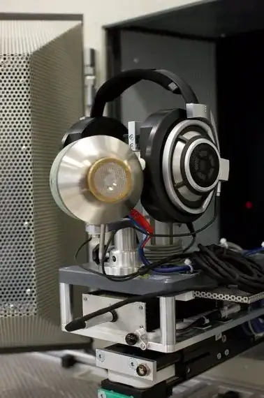

The pictures of the testing are there to be seen but i can't find a frequency response graph that goes above 20kHz anywhere on the web. The ones that I have seen show typical mid/high range anomalies that all headphones seem to have BUT stop at 20kHz.
So, is it marketing hype? I suspect that it is. Having a frequency response exactly specified at 44.1kHz is totally bogus to me. It's trying to impart "stuff" to the potential "soft" buyer that is irrelevant. 44.1kHz (as a signal), sampled at 44.1kHz produces (due to aliasing) a frequency of exactly 0 (zero, zilch) hertz i.e. dc!!
