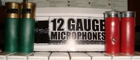

12 gauge microphones are another option at $35 and $45. electret, but sound ok. review with audio samples here:
http://audiogeekzine.com/2012/01/review-12-gauge-microphones-red12-and-green12/

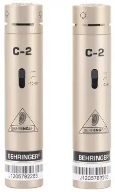

I have taped a pair of Behringer C2's (cardioid) to the underside of a sports car with good results. No super sound, but adequate.
Talking about cheap, they retail for € 49 for a pair!
