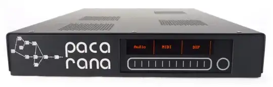

I'm deeply interesting in purchasing a Pacarana. I use Max/MSP a lot, and while that's super powerful for tool creation, it's also super difficult to get something to sound awesome.
Oh, yeah, and super time consuming.
What can you say about your experience with Kyma? How does it fit into your workflow? Your answers will help me decide where to put this $3k I was otherwise going to spend on things like eating and rent.
