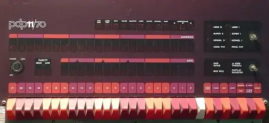

Error codes are an anachronism, they stem from ye olden days when output was really hard and expensive, and the only way to signal an error condition may have been through a bunch of front panel lights: pdp11/70 front panel
These days, we have mature exception handling built into pretty much every mainstream language. Use it. Give the user information they can work with; don't bother them with technical blah-blah, but rather tell them roughly what went wrong and what they can do about it. For logging, just give your exceptions descriptive names, and log the name. Easier to remember, and also easier to find using grep or similar search tools.

  • Your use of illustration matches your argument perfectly. I've read about PDP-11's forever. But this is actually the first one I've ever seen. Thanks. – Mike Owens Aug 02 '11 at 21:26

  • @Mike: The image is from the wikipedia article on the PDP-11 series; if that isn't easy to find I don't know what is. – tdammers Aug 14 '11 at 08:15
  • I have used those switches to enter a boot-loader and restart a PDP-11. – kevin cline Feb 07 '12 at 23:17
