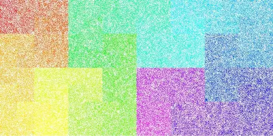

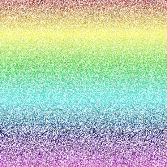

The other subjective measure is how randomly distributed the hashes are. Mapping the resulting HashTables shows how evenly the data is distributed. All the hash functions show good distribution when mapping the table linearly:
Or as a Hilbert Map (XKCD is always relevant):

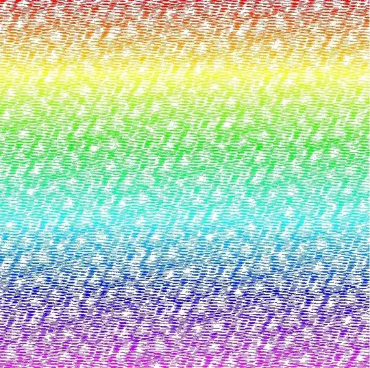

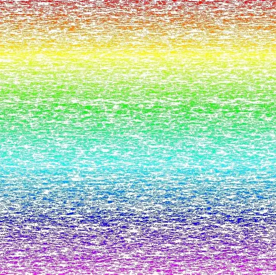

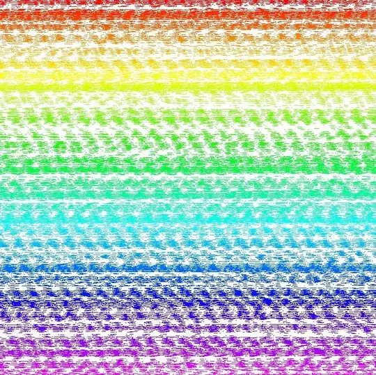

Except when hashing number strings ("1", "2", ..., "216553") (for example, zip codes), where patterns begin to emerge in most of the hashing algorithms:
SDBM:
DJB2a:
FNV-1:

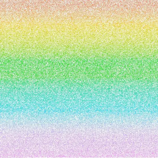

All except FNV-1a, which still look pretty random to me:
In fact, Murmur2 seems to have even better randomness with Numbers than FNV-1a:
When I look at the FNV-1a "number" map, I think I see subtle vertical patterns. With Murmur I see no patterns at all. What do you think?
