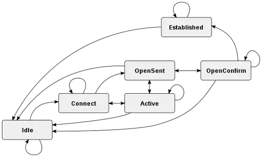

Border Gateway Protocol Example
BGP is a protocol which backs the the core routing decisions on the internet. It maintains a table to determine the reachability of hosts from a given node, and made the internet truly decentralized.
In the network, each BGP node is a peer, and uses a finite state machine, with one of six states Idle, Connect, Active, OpenSent, OpenConfirm, and Established. Each peer connection in the network maintains one of these states.
The BGP protocol determines the messages that are sent to peers in order to change their state.
BPG statechart.
BGP statechart
Idle
The first state Idle. In this state, BGP initializes resources, and refuses inbound connection attempts, and initiates a connection to the peer.
Connect
The second state Connect. In this state, the router waits for the connection to complete and transitions to the OpenSent state if successful. If unsuccessful, it resets the ConnectRetry timer and transitions to the Active state upon expiration.
Active
In the Active state, the router resets the ConnectRetry timer to zero and returns to the Connect state.
OpenSent
In the OpenSent state, the router sends an Open message and waits for one in return. Keepalive messages are exchanged and, upon successful receipt, the router is placed into the Established state.
Established
In the Established state, the router can send/receive: Keepalive; Update; and Notification messages to/from its peer.
More info about BGP is on wikipedia
ocodo
  • 2,947
  • @tcrosley - it's from wikipedia, so doesn't really deserve credit. – ocodo Feb 15 '11 at 00:22
    ok, +1 for including a diagram. :) – tcrosley Feb 15 '11 at 00:33

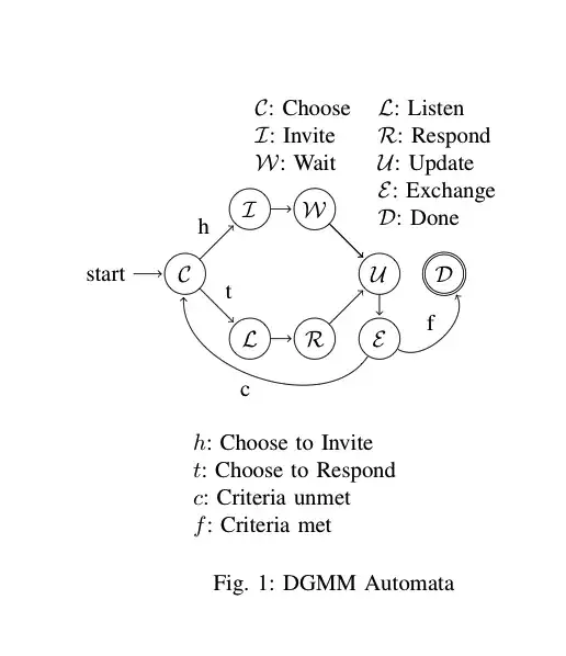

Finite State Machine in Ruby:
module Dec_Acts
 def do_next
    @now = @next
    case @now
    when :invite
      choose_round_partner
      @next = :wait
    when :listen
      @next = :respond
    when :respond
      evaluate_invites
      @next = :update_in
    when :wait
      @next = :update_out
    when :update_in, :update_out
      update_edges
      clear_invites
      @next = :exchange
    when :exchange
      update_colors
      clear_invites
      @next = :choose
    when :choose
      reset_variables
      choose_role
    when :done
      @next = :done
    end
  end
end
That's the behavior of a single compute node in a distributed system, setting up a link based communication scheme. More or less. In Graphic form it looks something like this:

  • +1 Interesting. What does DGMM refer to? – Evan Plaice Dec 13 '12 at 02:50
  • @EvanPlaice it's Distributed Maximal-Matching-based Minimum-Weighted Vertex Cover Algorithm (DGMM) ... a slightly abbreviated acronym, don't ask me where the G comes from. – ocodo Dec 13 '12 at 09:18
  • @slomojo The "G" is for "Generalized", the sequential algorithm from which this is derived uses a technique called generalized maximal matching. – philosodad Jan 05 '13 at 01:17
  • @philosodad I assumed as much, but I dislike posting assumptions. – ocodo Jan 05 '13 at 03:31
