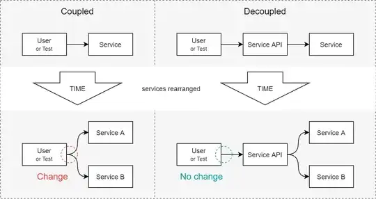

I offer you a (hopefully) better illustration:
diagram
You are right to be confused, because the original example is somewhat inconsistent, and the explanation that follows it is cursory and depends too much on the context outside of the article.
The one point I want to highlight is the fact that the example is supposed to demonstrate decoupling, but it also includes consolidation — an unrelated design change. This is distracting, because the consolidation is very apparent and draws too much attention. The author should've either demonstrated decoupling without introducing unrelated design changes or made it clear why/how that design change was important.
But, you're also wrong in the assumption that API is necessarily an endpoint. In the context of web development, the API could be the same layer that you plug into a web framework / reverse proxy. Which means that tests may consume it directly, without spinning up a server.
With all that established, I hope the connection with tests is clear now: if the tests are designed to go through the same indirection the user goes, then the tests will benefit from the indirection the same way the user does: rearranging the implementation should have no impact on the tests.
This is another way of saying that high-level test (that go after the public interface) must be preferred to low-level tests (that are concerned with implementation details).
