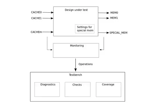

I'm working on a program that tests a digital circuit. The digital circuit can process accesses from multiple different caches, CACHE0, CACHE1, etc. The digital circuit can handle accesses to different memories MEM0, MEM1, etc. and a special kind of memory SPECIAL_MEM. The special memory can be accessed in multiple modes.
Here's a block diagram of my setup:
The design under test (DUT) is the digital circuit I am testing.
The monitoring block looks at the input and output signals of the DUT and figures out what kind of access is going on (e.g. from CACHE0 to MEM1). It creates one object for the current operation and sends it to the testbench.
The testbench performs different tasks on the objects it receives:
- logging of operations that are seen to allow for easy debug
- checks that certain requirements are met w.r.t. the operations (e.g. that the data written from the cache is the same as the one written to the memory)
- covers which operations were seen during the test run and stores this information in a special kind of database (e.g. we've seen that we've done accesses from
CACHE1to all memories except toSPECIAL_MEM)
I need to be able to model all types of accesses that can happen. If I think in term of properties that an access has, these are the cache_kind and the memory_kind. When the memory_kind is SPECIAL_MEM, though, there is also the special_mem_mode property. In my real life project there are actually many more properties I need to handle, but I want to keep the example brief and (hopefully) understandable.
Another thing to keep in mind is that in my professional field there is an over-reliance on data objects, as opposed to using objects with polymorphic behavior. You observe the inputs of the digital circuit, waiting for changes that signal a new access, create an object that describes that access and send it to different parts of your program to do different things based on it.
I'm working in an object oriented programming language called SystemVerilog, which borrows a bit from C++ and Java. I'm not sure what the best way is to model my accesses.
