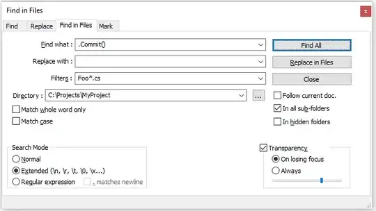

Even Notepad++ can be a tremendous help sometimes. When you press Ctrl + Shift + F, you get an advanced find window. To showcase how finetuned your search can be, an example:
We're dealing with a bug where a Foo object is being saved to the database containing wrong data. We have no idea how to begin looking for it. But we know that since it's being saved to the db, our unit of work's Commit() method is being called. That gives us a keyphrase to look for.
However, this method is used all over the place for all of our entities. We want to refine it to find Foo-specific instances.
A good first attempt could be:
We're looking for the Commit() method call, but we're limiting our search to files that follow the Foo*.cs format, i.e. C# code from classes whose name starts with Foo. If you used a clear naming scheme, you're most commonly going to expect to find hits in files such as FooRepository.cs, which matches the filter we've defined.
This is just a simple example, but it's easy to see that when your filenames (and class names) follow a consistent pattern, that you can use this pattern to find these specific files.
