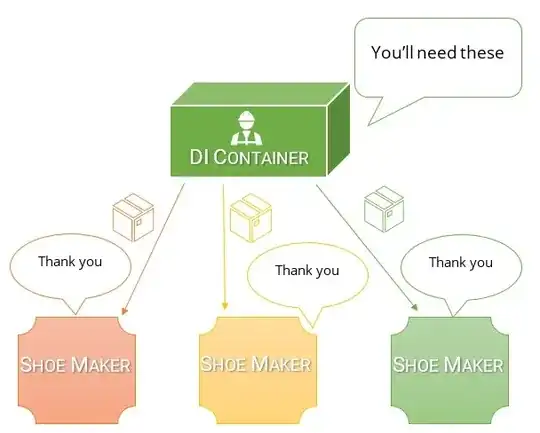

service locator
A Dependency Injection (DI) Container is like a big box that gets filled with everything that everyone needs at the start of the day.
As the factory starts up, the Big Boss known as the Composition Root grabs the container and hands out everything to the Line Managers.
The Line Managers now have what they need to conduct their duties for the day. They take what they have and pass what is needed to their subordinates.
This process continues, with dependencies trickling down the line of production. Eventually a container of materials and tools shows up for your Foreman.
Your Foreman now distributes exactly what you need to you and other workers, without you even asking for them.
Basically, as soon as you show up for work, everything you need is already there in a box waiting for you. You didn't need to know anything about how to get them.
dependency injection container

    This is an excellent description of what each of those 2 things are, super good-looking diagrams too! But this does not answer the question of "Why choose one over the other"? – Matthieu M. Apr 23 '19 at 07:49
