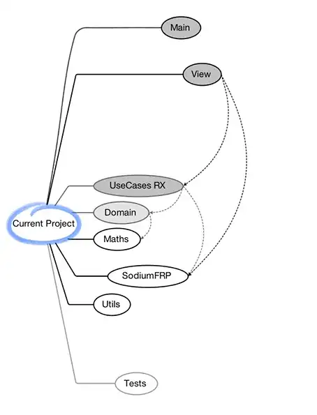

Background: I'm building a prototype scientific app with the "Exploration" and "Optimisation" parts. (Other parts might be needed later.) Each part uses functional reactive programming (FRP) and has its own GUI window. "Optimisation" depends on the user's choices within "Exploration"; there's no dependency the other way. Although the language is Scala, integration with Python, and possibly R, will be needed in future.
First, I've built an "Exploration"-only app based on the "onion" (clean) architecture and DDD principles. (The app is implemented as a multi-module sbt project in Intellij; see Figure 1.) I'm happy with this individual app.
"Exploration"-only Project. "Onion modules" shaded. Omitted dependencies: Main on every module; every module on Utils
Figure 1: "Exploration"-only project with the "onion modules" shaded. Omitted dependencies: Main on every module; every module on Utils.

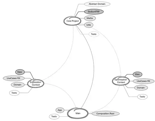

My current idea is to split the project into four separate multi-module projects; see Figure 2. The independent "Core Project" contains all the support domains and the abstract core domain. The "Exploration" and "Optimisation" projects depend on it as an external project. The "Main" project, dependant on the other three, wires the whole application and is responsible for passing data from "Exploration" to "Optimisation".
Question: Is this solution reasonable and how could it be improved? Or is there a better solution?

Split project. Between-Project dependencies (dashed lines) go upwards
Figure 2: Split into 4 external projects. Between-project dependencies (dashed lines) point upwards

Problems started when adding the "Optimisation" part to the same Intellij project. In DDD terms, "Exploration" and "Optimisation" are distinct bounded contexts. Combining both in one project would require having two "onions" side-by-side. The complexity is noticeably greater than with the "Exploration"-only project.
Merging two DDD codebases inherently means that their individual boundaries cease to exist, and they instead use shared boundaries. To describe it visually, you're thinking of your merged codebase this:
  Exploration      Optimization
┌─────────────┐ ┌─────────────┐ │ Persistence │ │ Persistence │ └──────▲──────┘ └──────▲──────┘ │ │ │ │ ┌──────┴──────┐ ┌──────┴──────┐ │ Domain │ │ Domain │ └──────┬──────┘ └──────┬──────┘ │ │ │ │ ┌──────▼──────┐ ┌──────▼──────┐ │ Application │ │ Application │ └─────────────┘ └─────────────┘
But it should be this:
   Exploration + Optimization
┌───────────────────────────────┐ │ Persistence │ └───────────────▲───────────────┘ │ │ ┌───────────────┴───────────────┐ │ Domain │ └───────────────┬───────────────┘ │ │ ┌───────────────▼───────────────┐ │ Application │ └───────────────────────────────┘
To use your diagrams, I would expect your merged diagram to merge their bubbles. There shouldn't be a separate "View" bubble for exploration and optimization. There should be one "View" bubble which is the combined content of those two bubbles.
When you start applying this to your diagram, you'll notice that all the bubbles of the same name merge into the same blob.
Everything from the same layer should be merged with one another, since it now all belongs to the same layer. Let go of the old boundaries, embrace the new ones (from a code structure perspective. Whether you separate them for the end user is a different story).
Merging the bubbles doesn't mean that these merged bubbles must invariably interact with one another. They often don't. If we were to observe a specific use case threaded across these layers, the entire use case would usually entirely belong to one of the old parts, i.e. it's completely Optimization or completely Exploration logic.
That's not a problem. There is no inherent requirement that code that lives in the same project are forced to interact with one another. It is very common for bounded contexts within the same domain to either never interact with one another, or only marginally interact with other bounded contexts which reference them (e.g. how an Order references the Products of a webshop, even though they're separate bounded contexts in all other regards).
