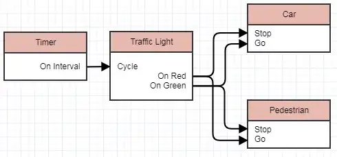

If we use the traffic light example, then immediately a naive attempt would want to give such traffic light knowledge of the entire world that surrounds it, and that would certainly be undesirable from a coupling perspective. So if I understand correctly you abstract that away and decouple in favor of generalizing the concept of I/O ports which further propagate messages and requests, not data, through the pipeline, and basically inject these objects with the desired interactions/requests among each other while oblivious to each other.
The Nodal Pipeline
And that diagram is about as far as I got trying to sketch this out (and while simple, I had to keep changing it and rethinking it). Immediately I tend to think a design with this level of decoupling and abstraction would find its way becoming very difficult to reason about in code form, because the orchestrator(s) who wire all these things up for a complex world might find it very difficult to keep track of all these interactions and requests in order to create the desired pipeline. In visual form, however, it might be reasonably straightforward to just draw these things out as a graph and link everything up and see things happening interactively.

So to clarify I was imagining how you actually program this. The way I was seeing it working was actually the diagram above capturing the user-end (programmer's) workflow. You can drag a traffic light into the world, drag a timer, give it an elapsed period (upon "constructing" it). The timer has an On Interval event (output port), you can connect that to the traffic light so that on such events, it's telling the light to cycle through its colors.
The traffic light might then, on switching to certain colors, emit outputs (events) like, On Red, at which point we might drag a pedestrian into our world and make that event tell the pedestrian to start walking... or we might drag birds into our scene and make it so when the light turns red, we tell birds to start flying and flapping their wings... or maybe when the light turns red, we tell a bomb to explode -- whatever we want, and with the objects being completely oblivious to each other, and doing nothing but indirectly telling each other what to do through this abstract input/output concept.
And they fully encapsulate their state and reveal nothing about it (unless these "events" are considered TMI, at which point I'd have to rethink things a lot), they tell each other things to do indirectly, they don't ask. And they're uber decoupled. Nothing knows about anything except this generalized input/output port abstraction.
