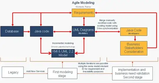

There is today a split inside the Eclipse community between traditional UML tools focused on MDD in which the model drives the code/development and Omondo which considers that iterations should drive the development process and certainly not only the model.
I agree with them because MDD is crap while UML is really an excellent way because standardize in order to communicate with other team members. alt text
