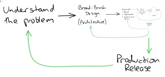

In the talk Test-Driven Development: This is not what we meant Steve Freeman shows the following slide of the TDD big picture (see image below answer). This includes a step "Write a failing end-to-end test" which is followed up by "Write a failing unit-test". (Click to zoom in, its in the top right)
So no in TDD the tests are not always unit-tests.
And yes you can (and maybe should) start with a higher-level end-to-end test that fails before you write you first unit-test. This test describes the behavior you want to achieve. This generates coverage on more levels of the test-pyramid. Adrian Sutton explains LMAX's experience which shows that end-to-end tests can play a large and valuable role.
