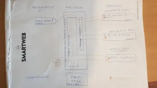

An example of how command validators work:
Command's path through command validators on its way to the Aggregate

  • Can you give me a concrete example? I'm interested in how this is implemented. Here's the flow I'm imagining: a CreateUserValidator is initialized (on startup?) that subscribes to multiple events which is then invoked with a CreateUser command to which it provides validation according the the events it previously received. What kind of events could it receive before the command reaches it? A `VisitorAcceptedPrivacyStatement' event? How is it not deterministic in nature? It seems like that information could simply be included on the command itself. This sounds like a distributed ... – user3347715 Feb 23 '18 at 21:58
  • ... service where, instead of having application Services which are injected with outside information (repositories etc.) that have methods which handle commands by orchestrating domain objects, you've separated and isolated each of these methods into their own classes named "command validators". Functionally, these seem like similar concepts (save the whole event subscribing bit). I think you've reached a hybrid between a process manager and an application service. Process managers are perfectly capable of rejecting commands (events) according to the state of the process it's managing – user3347715 Feb 23 '18 at 22:05
    @king-side-slide A concrete example is UserCanPlaceOrdersOnlyIfHeIsNotLockedValidator. You can see that this is a separate domain that of the Orders so it can't be validated by the OrderAggregate itself. – Constantin Galbenu Feb 24 '18 at 00:44
  • What is it about that rule that puts it in a separate domain? What data does your validator require? Is there nowhere in your domain where that data is naturally grouped? Why not? It seems like a rule like that would be grouped with whatever cross-section of your User can place orders (Buyer?). I have found that rules like your example are usually found in an anemic model. Where the code base is largely built in a procedural paradigm modeled as objects. Functions are elevated to objects and data is encapsulated and passed around for processing. Objects generally have lots of getters. – user3347715 Feb 24 '18 at 05:01
  • @king-side-slide I respond only in chat. – Constantin Galbenu Feb 24 '18 at 07:25
