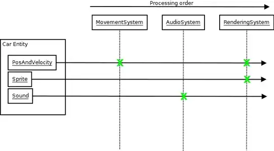

Meanwhile the most effective way I've ever witnessed after exhausting techniques to reduce compile times in large codebases are architectures which genuinely reduce the amount of information required for any one thing in the system to work, not just decoupling one header from another from a compiler perspective but requiring the users of these interfaces to do what they need to do while knowing (both from a human and compiler standpoint, true decoupling that goes beyond compiler dependencies) the bare minimum.
The ECS is just one example (and I'm not suggesting you use one), but encountering it showed me that you can have some really epic codebases that still build surprisingly quickly while happily utilizing templates and lots of other goodies because the ECS, by nature, creates a very decoupled architecture where systems only need to know about the ECS database and typically only a handful of component types (sometimes just one) to do their thing:
