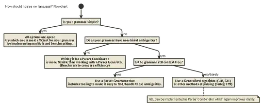

Tl;Dr:
Here is a flowchart that is applicable to most cases: enter image description here

  • In any case, I have added a tl;dr flowchart to the question. Does that satisfy you, @Sjoerd ? – Qqwy Dec 26 '16 at 15:36

As Karl mentions, parser generators tend to have better error reporting. In addition:
  • they tend to be faster, since the generated code can be specialized for the syntax and generate jump tables for the lookahead.
  • they tend to have better tooling, to identify ambiguous syntax, remove left recursion, fill in error branches, etc.
  • they tend to handle recursive definitions better.
  • they tend to be more robust, since generators have been along longer and do more of the boilerplate for you, reducing the chance of you screwing it up.
On the other hand, combinators' have their own advantages:
  • they are in code, so if your syntax varies at runtime, you can more easily mutate things.
  • they tend to be easier to tie into and actually consume (the output of parser generators tends to be very generic and awkward to use).
  • they are in code, so tend to be a little easier to debug when your grammar doesn't do what you expect.
  • they tend to have a shallower learning curve since they work like any other code. Parser generators tend to have their own quirks to learn to get stuff working.
