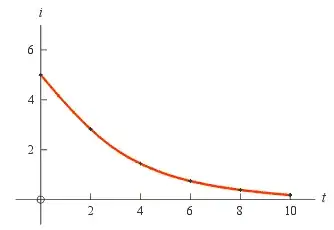

Another thing is defects. Over time the system should stabilize. Ideally new defects should trend toward zero or flatten out to a low number, which means new and current defects should decrease over time.
The plot should look something like this:
Defects Over Time Defects Over Times
If they stay constant or increase, then the software is not good. Your only 4 months in, so I would give it a few more months to a year. After 6 months to a year, if you had a constant stream of defects, then it's bad quality. Your team developed another ball of mud.
