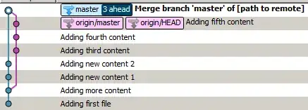

If you execute git pull with the default settings, you'll get something like this:
merge commit
This is because git performed a merge.

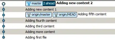

There's an alternative, though. You can tell pull to do a rebase instead:
git pull --rebase
and you'll get this:
rebased
In my opinion, the rebased version has numerous advantages that mostly center around keeping both your code and the history clean, so I'm a little struck by the fact that git does the merge by default. Yes, the hashes of your local commits will get changed, but this seems like a small price to pay for the simpler history you get in return.
