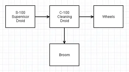

A long time ago, in a galaxy far, far away, there existed two droids: a supervisor droid (model S-100) who was programmed to routinely issue requests to a cleaner droid (model C-100) to clean a room. The cleaner droid was programmed to grab a broom, use its wheels to go to the appropriate location, and begin cleaning the dirty room.

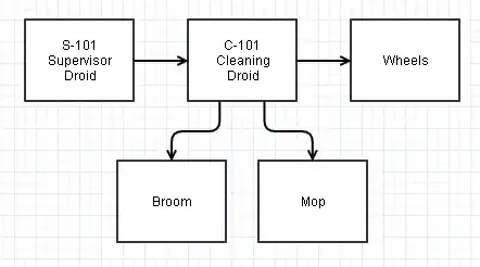

This was all fine and dandy, until the invention of a new cleaning device for certain situations known as a mop.
Since the C-100 was not programmed to use a mop, a new model of cleaning droid had to be invented that could utilize both a broom and a mop, known as C-101.
However, since the S-100 was not programmed to communicate with anything but a C-100, a new model of the supervisor, S-101, also had to be created to account for C-101.

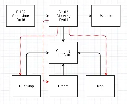

... until the invention of a new cleaning device known to the mystics as the dust mop.
At this point, the designers were getting fed up. To create a new C-102 model here to handle this new and alien cleaning device would likewise require a new S-102 model.
To solve this problem, the elders convened and decided that all of these cleaning devices should be standardized with an abstract cleaning interface.
This abstract cleaning interface allowed the new C-102 to work with any compatible cleaning device through this common interface. Unfortunately this still required a new S-102 to be designed to interface with C-102, but the designers were confident that no new cleaning devices introduced hereafter would require a new supervisor model.
