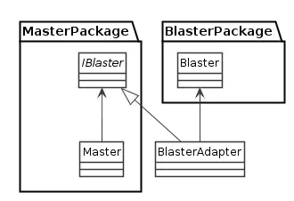

Suppose I have MasterPackage containing a Master class, and BlasterPackage containing Blaster class. Since Master needs a Blaster to work, the higher level MasterPackage depends directly on lower-level BlasterPackage.
Using classic Dependency Inversion, one would add IBlaster (or AbstractBlaster) to MasterPackage, thus inverting dependency between the packages.
But while facing this problem, I realized I could create a third package - let's name it MasterBlasterInterfaces - and put IBlaster there. That would "delegate" the dependency to that third, common package, and the original two packages would be now decoupled from one another.
But then, if I have a higer-level package called ThunderDome, it will have to deal directly with BlasterPackage, wouldn't it? I feel like it sort of violates encapsulation, while with direct dependency Master could possibly abstract away the very existence of Blaster.
