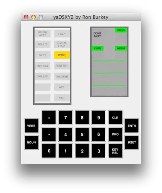

The AGC is controlled with verbs and nouns
The Apollo command software is not written in any syntax users would recognize today. Astronauts input commands numerically, with each two-digit number representing a verb or a noun. The verb described the action to be performed, and the noun specified the data to be affected by the verb’s action.
Astronauts hated the verb and noun setup
Ramón Alonso, one of the original AGC hardware developers, said the interface had been invented to impress visitors to their lab, but stuck around for the flights when nobody developed a better interface. Critics said it wasn’t "scientific," and the first astronauts—all elite jet pilots—preferred dials and switches, similar to an airplane control panel.
"The AGC was very slow, but very reliable and very small for that time in the history of digital computers. It was the earliest to use integrated circuits."
The software as it was designed was built basically from scratch by MIT.
You can download and install the Apollo Guidance Computer emulator program on your personal computer, no problem. Here’s what it looks like on Mac OS X.
